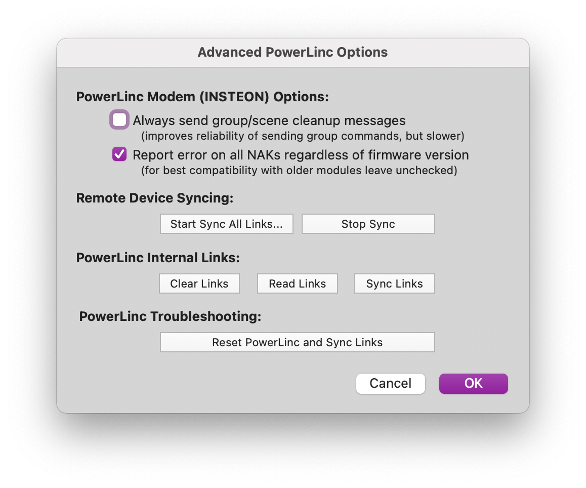

If you click on the Interface Options... button, you'll see something like this:

Resetting your PowerLinc
  5. Release the button
Replacing Your PowerLinc
If your PowerLinc is ever replaced, then you must re-sync all of your devices. This will ensure that all devices have their internal links updated to reflect the new PowerLinc's Insteon address. If you are replacing a 2414U with a newer PowerLinc, you may also need to install the drivers for your new PowerLinc.
