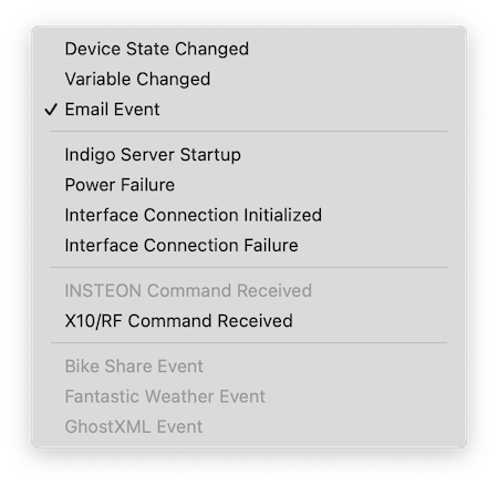

Email Event
Email Event Image
  • String Match in Email - use this option to trigger an event when an email is received that matches a particular string pattern you choose. Select "Edit Event Settings" to choose the Email device, match in Message Text, Message Subject, or Message From, and the string pattern to match. Note that this is an exact text match, so this trigger will only fire when the string matches the target text 100 percent.
  • Regex Pattern Match in Email - use this option to trigger an event when an email is received that matches a portion of the text pattern you choose. The match is done using a Regular Expression pattern match, which allows greater flexibility and the ability to match on a portion of the target text. Select "Edit Event Settings" to choose the Email device, match in Message Text, Message Subject, or Message From, and the regex pattern to match. For more information on regular expressions, visit https://www.regular-expressions.info/tutorial.html.
  • Server Connection Error - use this option to trigger an event when the connection to a specific email server is lost. Select "Edit Event Settings" to select the email device you want to monitor.
Indigo Server Startup
Power Failure
Interface Connection Failure

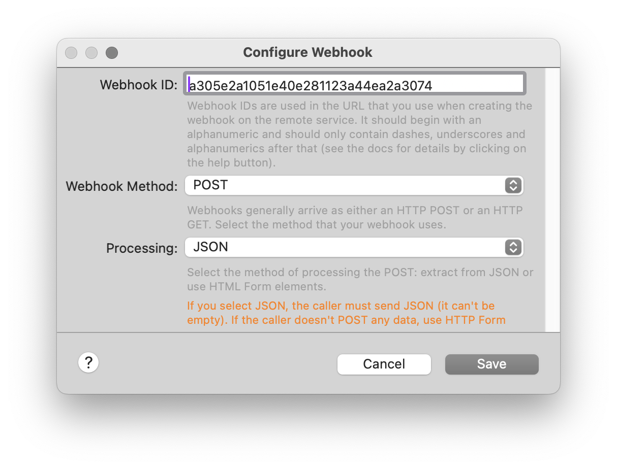

Web Server Event
Use the type Web Server Event to trigger an action when a webhook is called. Set the type Web Server Event and set the Event to Webhook.
Field Description
Webhook ID This is a random code generated by Indigo. It's used to identify which webhook is associated with the event. You can use the code provided or use one of your own. NOTE: if someone has your Reflector URL and the webhook ID, they can cause the event to fire. If you use your own ID, it's best not to make it easily guessable.
Webhook Method
[POST]
Use POST to indicate that the webhook is sending information to Indigo and not expecting data in return
POST Processing
[JSON]
this type of webhook will accept a POST and interpret the payload as JSON.
POST Processing
[HTML Form]
this type of webhook will accept a POST with optional form data, which will be converted into a dict of name-value pairs and passed through as data.
Webhook Method
[GET]
this type of webhook will accept a GET and will pass through any query arguments as the data element. GET webhooks do not have settings for processing the associated payload.
You can find more information on the Webhooks page. You can find more information about using substitutions on the Indigo substitutions page.
