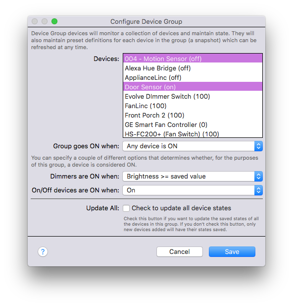

With the addition of Z-Wave (and various plugins that define dimmer and relay devices) it has become apparent that we need to provide some way to create technology-agnostic groups of devices. You can, of course, control groups of devices through Action Groups, and for most cases that's good enough.
We've also added a twist to this device. When we create the device (and any time later), we save off the current state of each device in the group. It's like taking a snapshot of each device. When you turn ON the group, we'll use the value that the device had when you last saved the device states. We think you'll really love this feature since you can set all the devices how you want them, then save the device states.
Select the devices you want to be in the group (only dimmer devices, relay (on/off) devices, and sensor devices that support an on/off state are available). To select multiple devices, hold down the command key and click the device in the list. Notice that the devices all have something in parentheses after the name - that's the current value of the device that will be saved. If it's a dimmer device, it shows the brightness and if it's a relay (On/Off) device, it shows whether it's on or off. When you save, that's the value that will be saved. These values will be used when the group is turned on.
To use a device group, just use the standard Control Light/Appliance action to turn it ON/OFF, and create triggers on the group's ON and OFF state via the Device State Changed trigger type. Turning a device group on will set all the devices to their respective saved states. You can also update the states of the devices in the group at any time by using the Update Device Group States action or menu item. That's it!

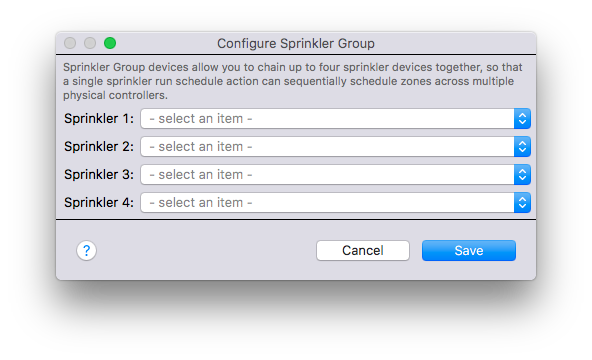

Sprinkler Group

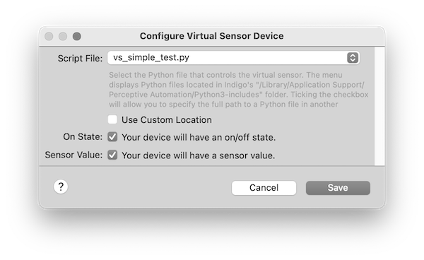

Virtual Sensors are plugin devices that are linked to external Python scripts that send instructions to the Virtual Device so it can be used to track a desired status. The device also sends information back to the external script for further processing if needed.
Say you want to use an external script to send a value to the Virtual Device based on some logic in your script and then fire an Indigo Trigger based on the result. You would create a Virtual Sensor, link it to your external script, and set up an update Action to tell the Virtual Sensor to request a status update from your script.
Virtual Sensor Configuration Dialog Image
Supported States
Virtual Sensors support two states and must support at least one of the following:
  • On State - your device will have an on/off state.
  • Sensor Value - your device will have a sensor value.
Script Locations
You can add scripts directly to the /Library/Application Support/Perceptive Automation/Python3-includes folder, or you can point to a script in any location that Indigo has the authority to access. Python scripts that are saved to the above folder will be available in the Script File dropdown menu. Alternatively, you can check the Custom Location checkbox and a field will open for you to enter the full path to the script file.
