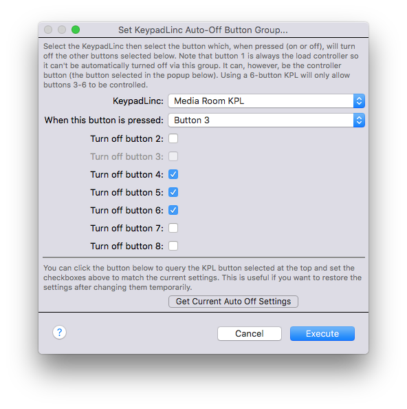

In Indigo 6, we added some convenient menu items on the Interfaces->Insteon/X10 Power Line submenu to perform some advanced Insteon configuration functions. First, you want to create the auto-off button groups which will cause the other buttons to go off when one of the buttons is pressed (goes on). Select the Interfaces->Insteon/X10 Power Line->Set KeypadLinc Auto-Off Button Group... menu item, and you'll see this dialog:
Auto Off Button Group Menu Image
Select the KeypadLinc you want to work with from the KeypadLinc popup. Then, for each button in the group, repeat these steps:
  1. Select a button in the group (for instance, button 3) that, when pressed, should cause the other buttons to go out
  2. Select the checkboxes next to the other buttons in the group (for instance, 4, 5, and 6) that should go out when the button selected above is pressed
  3. Click Execute
Repeat for buttons 4-6. This creates the auto-off functionality.

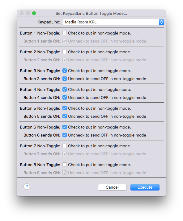

Next, we want to configure the buttons to always go ON (and send the ON command) when pressed. This is called non-toggle mode because the buttons don't toggle on and off when you press them. Select the Interfaces->Insteon/X10 Power Line->Set KeypadLinc Button Toggle Mode... menu item, and you'll see this dialog:
Button Toggle Mode Menu Image
Select the Non-Toggle checkbox for each button in the group (3, 4, 5, and 6). Leave the Button X sends ON checkbox checked, since you want those buttons to always send ON commands. When you have them all selected, click Execute.
That's it - your buttons are now configured in a radio group. Proceed to the Creating the Links section for the next steps.

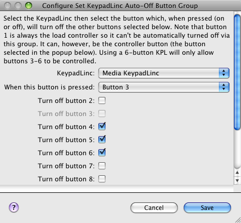

What you'll do is create an Action Group that executes several plugin actions, each of which will send the appropriate commands to the KeypadLinc. Once you've created the Action Group, you will execute it and several seconds later your KeypadLinc will be configured correctly. Specifically, you'll need to use two of the actions in this plugin to create your radio group. First, create an Action Group (called "Set up radio group" or something) and create a Set KeypadLinc Auto-Off Button Group for each button (3-6) that will turn OFF all the other buttons. For instance, here's the configuration for button 3:
Auto Off Button Group Image

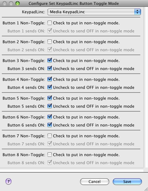

Repeat the action for each of the other (4-6) buttons, turning off the rest. Next, create a Set KeypadLinc Button Toggle Mode action that sets buttons 3-6 to Non-Toggle mode (and leave the Button # sends ON checkboxes checked):
Toggle Button Image
That's it - execute the Action Group and the buttons should be set up such that when you press one it will go on and the others will go off. If not, revisit each of your actions and make sure that you have them configured correctly.
