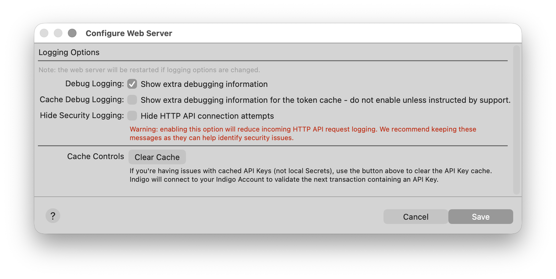

Select the Indigo 2026.1->Advanced Web Server Settings... menu item and you'll get this dialog:
Web Server Settings Dialog
The dialog has four options:
  1. Debug Logging: Enable this setting to show extra Web Server debugging information.
  2. Hide Security Logging: Enable this setting to hide HTTP API connection attempts. Warning: enabling this will reduce the logging of incoming HTTP API requests. We recommend keeping these messages as they can help identify security issues.
  3. New in 2026.1 Hide MCP Logging: Enable this setting to keep MCP activity out of the normal Event Log. The messages are demoted to debug level rather than discarded, so they still appear with Debug Logging on.
  4. Cache Controls: If you are having issues with cached API Keys (not Local Secrets), use the button to clear the key cache. This will force Indigo to connect to your Indigo Account to validate the next transaction which contains an API Key.
