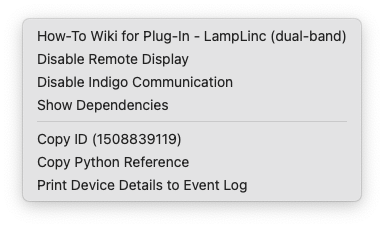

Device Contextual Menu Image
This menu will:
  5. Open the Assign Tags sheet, where you can put tags on the selected devices. It's also on the Edit menu. To create, rename, recolor or delete tags, use Edit → Manage Tags…, which opens the Tags tab of General Settings.
  6. Copy the unique ID of the device to the clipboard - to assist in writing Python scripts that use the device
  7. Copy a Python script string that will return an instance of the selected device. It will look like this: indigo.devices[91776575] # "Living Room Switch"
  8. Print all the information about a device to the Event Log window. It will look something like this:
    address : 3B.04.7A
    batteryLevel : None
    blueLevel : None
    brightness : 0
    buttonConfiguredCount : 0
    buttonGroupCount : 1
    configured : True
    defaultBrightness : 100
    description : valve
    deviceTypeId :
    displayStateValRaw : 0
    displayStateValUi : 0
    enabled : True
    energyAccumBaseTime : None
    energyAccumTimeDelta : None
    energyAccumTotal : None
    energyCurLevel : None
    errorState :
    folderId : 810233868
              publish-device : true (bool)
              sub-type : Valve (string)
              voice-name : valve (string)
    greenLevel : None
    ledStates : []
    model : LampLinc (dual-band)
    onBrightensToLast : False
    onState : False
    pluginId :
    protocol : Insteon
    redLevel : None
    remoteDisplay : True
    states : States : (dict)
         brightnessLevel : 0 (integer)
    subModel : Plug-In
    subType : Plug-In
    supportsAllLightsOnOff : True
    supportsAllOff : True
    supportsColor : False
    supportsRGB : False
    supportsStatusRequest : True
    supportsWhite : False
    version : 67
    whiteLevel : None
    whiteLevel2 : None
    whiteTemperature : None

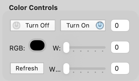

Color Controls Tile Image
The top row of controls allows you to turn the light On, Off, and the last text field will allow you to type in the brightness (0-100). The second row of controls allows you to set the color and if the light supports it, the white value (also 0-100). If the light doesn't support setting white separately, the slider and text field will not show. The last row will allow you to se the temperature of the white (again, if the light supports it). If the light doesn't allow setting temperature, the Send Status Request button will show instead.
