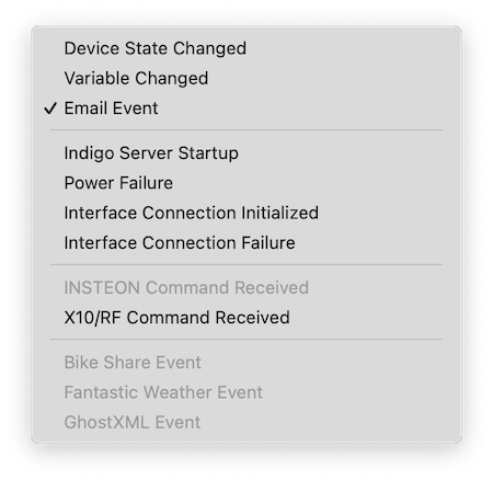

Triggers
Trigger Dialog Image
Device State Changed

Variable Changed
Note: becomes true will fire when the value becomes "true", "on", "yes", and "1" (if it wasn't one of those values previously). becomes false will fire when the value becomes "false", "off", "no", and "0" (if it wasn't one of those values previously). Any other value will be neither true nor false and neither will fire.
Email Event

Indigo Server Startup
Power Failure
Interface Connection Failure

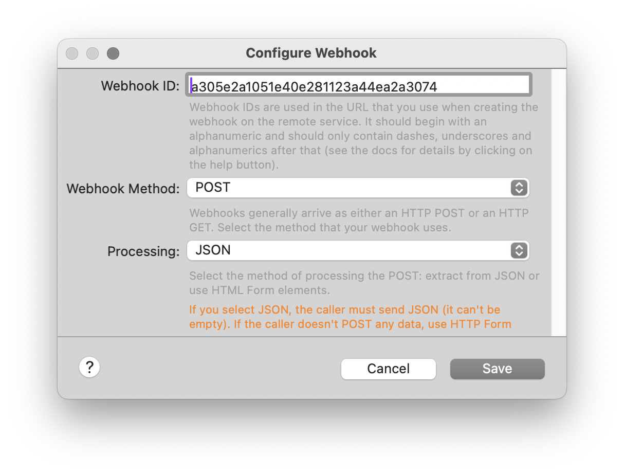

Web Server Event
Use the type Web Server Event to trigger an action when a webhook is called. Set the type Web Server Event and set the Event to Webhook.
Field Description
Webhook ID This is a random code generated by Indigo. It's used to identify which webhook is associated with the event. You can use the code provided or use one of your own. NOTE: if someone has your Reflector URL and the webhook ID, they can cause the event to fire. If you use your own ID, it's best not to make it easily guessable.
Webhook Method
[POST]
Use POST to indicate that the webhook is sending information to Indigo and not expecting data in return (your call will be
POST Processing
[JSON]
this type of webhook will accept a POST and interpret the payload as JSON.
POST Processing
[HTML Form]
this type of webhook will accept a POST with optional form data, which will be converted into a dict of name value pairs and passed through as data.
Webhook Method
[GET]
this type of webhook will accept a GET and will pass through any query arguments as the data element. GET webhooks do not have settings for processing the associated payload.
