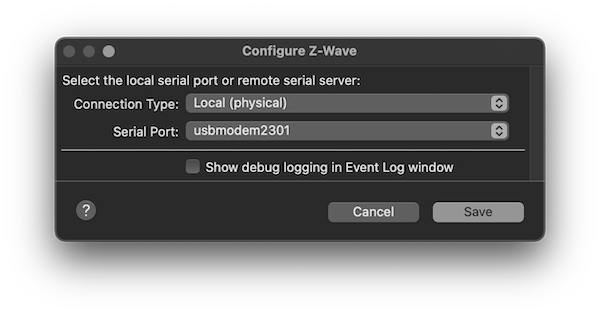

Connecting Z-Wave Interfaces
The GoControl QuickStick Combo is an interface that includes both Z-Wave and Zigbee (though Zigbee isn't supported natively in Indigo). It also requires that you install the Silicon Labs VCP Driver Kit for Mac OS X, specifically v5 or later. It will then present 2 new serial ports: GoControl_zwave (which is the one you select) and GoControl_zigbee (for the Zigbee interface).
Plug the Z-Stick into an available USB port connected to your Mac. We've done some testing with this interface connected to a USB hub with favorable results (unlike some other Insteon and X10 interfaces). However, if you experience any type of errors when trying to configure/use the interface you may try plugging the stick directly into a USB port on your Mac.

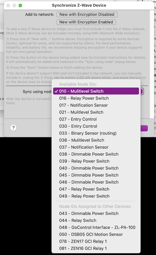

Adding a Z-Wave Device
IMPORTANT: When adding a device (particularly a battery-powered device), the device may enter sleep mode before we can finish all the sync activities needed to add the device. If this happens, you'll get an error before the sync is finished. In this case, you can often just repeatedly tap the include button/paddle, tamper button/mechanism, etc., to keep the device awake. Another option is to remove the batteries from the device and wait a few minutes. Then reinsert them (which will often put the device into an awake status for several minutes) then do the sync again.

Replacing a Z-Wave Device
  4. Follow the instructions on the dialog to use your controller to include the device into your network if you haven't already.
  5. Select the new device in the Sync using node popup.
Note that not all devices can be replaced. Specifically, if a device has multiple personalities (like, for instance, a multi-sensor that has a motion sensor, temp sensor, humidity sensor, etc.) and any of those dependent devices are used in Triggers, Conditions, Actions, or Control Pages, then you'll get an error message in the [Event Log window](../../mac-client/event-log.md#event-log-window) saying that you need to manually resolve those conflicts (or manually delete the device). Indigo helps with this process - see Deletion Dependencies for details.
IMPORTANT: When replacing or resyncing a device (particularly a battery-powered device), the device may enter sleep mode before we can finish all the sync activities needed to re-add the device. If this happens, you'll get an error before the sync is finished. In this case, you can often just repeatedly tap the include button/paddle, tamper button/mechanism, etc., to keep the device awake. Another option is to remove the batteries from the device and wait a few minutes. Then reinsert them (which will often put the device into an awake status for several minutes) then do the sync again.
