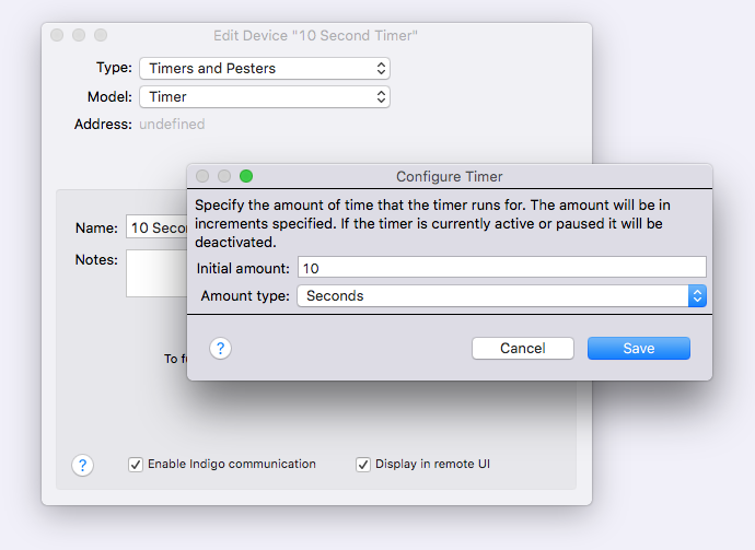

  1. Select DEVICES (or one of its subfolders) from the Outline View
  2. Click on the New... button
  3. In the resulting Create New Device dialog, select Timers and Pesters from the Type: popup
  4. Select Timer from the Model: menu
  5. In the resulting Configure Timer dialog, specify the amount of time the timer will default to when started and the time increments
  6. Click Save
  7. Name the timer something useful and close the Create New Device dialog
The timer device you created has 7 device states:
  • Timer Start Value - the default value of the timer when the Start Timer action is selected. It's set when you create a timer device and may be modified either via the device dialog or by using the Set Timer Start Value action.

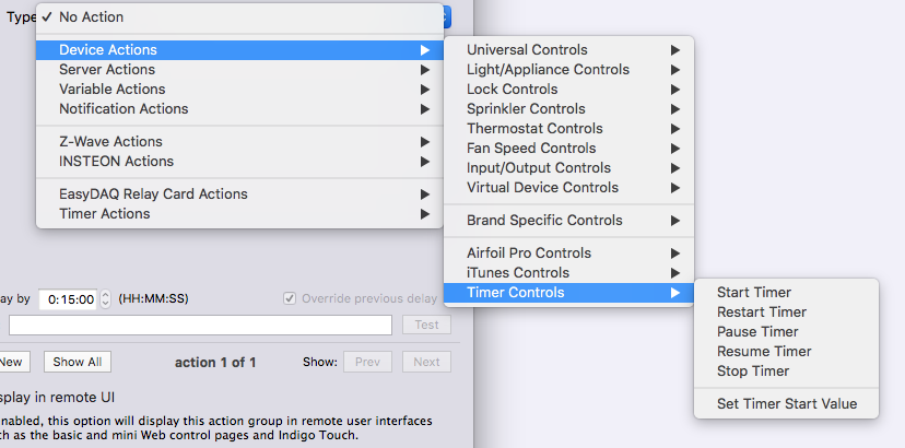

Timer Actions
Plugin Timers Actions Image
  • Start Timer - use this action to start a timer. The timer device will automatically start counting down and the state will change. When the countdown completes, the status will be set to "inactive" and any triggers that are triggering off of the Timer Expired event for this timer will be fired. The action will only start the timer when it's inactive and will be ignored when in any other state.
  • Restart Timer - use this action to restart a timer using the default time set for the timer. The action will always work regardless of the timer's current state.
  • Pause Timer - as the name implies, this action will pause the selected timer. The amount of time will not be modified so that you can resume the timer at will. The action will only pause an active timer and will be ignored when the timer is in any other state.
  • Resume Timer - use this action to resume a previously paused timer. The action will only resume a paused timer and will be ignored when the timer is in any other state.
  • Stop Timer - use this action to stop a timer prematurely. The state becomes "Inactive" and all the time left states will be set to 0. It will not cause any Timer Expired triggers to fire. The action will be ignored if the timer is already inactive.
  • Set Timer Start Value - use this action to set the default timer value without actually starting the timer. If the timer is running when it has its start value changed, it will stop running.

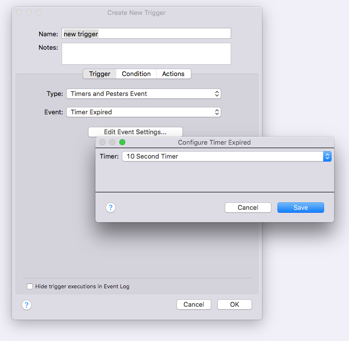

  1. Select TRIGGERS (or one of its subfolders) from the Outline View
  3. In the resulting Create New Trigger dialog, select Timers and Pesters Event from the Type: popup
  4. Select Timer Expired from the Event: menu
  5. In the resulting Configure Timer Expired dialog, specify the timer to watch
  6. Click Save
  7. Add any Conditions you need
  8. Add all the Actions you want to perform when the timer expires
  9. Name the trigger something useful and close the Create New Trigger dialog

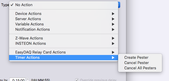

Another very useful feature of this plugin is the "Create Pester" action. This action will create a little mini timer which will repeat a specified number of times, executing an action group each time through and will execute an optional action group at the end of its final occurrence. So - say you want to have your computer announce that it's time to take out the trash. However, if you're like me, once is never enough - I need to be nagged about it several times. Create a pester that repeats every 30 seconds for 5 times (so it doesn't go forever) that executes an action group that tells you to take out the trash. The final time can send an SMS to your phone.
Pesters can be thought of as transient schedules - they only live for a limited amount of time. You give a pester a name so that you can later cancel it, or you can cancel all pesters.
