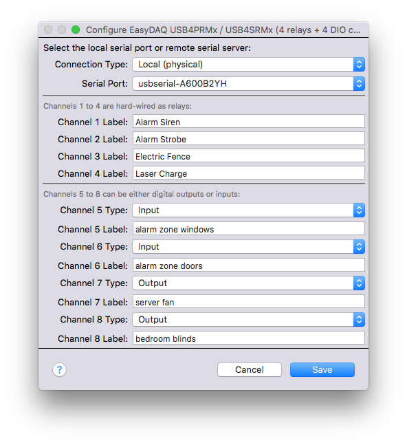

Next choose the File->New Device... menu item, select Plugin from the Type popup control, and EasyDAQ Relay Card from the Plugin popup control, and choose the correct Model. Press the Edit Device Settings... button to configure the card:
Easydaq Settings Window Image
The FTDI VCP driver adds the virtual serial port. Note you must have the card plugged into your Mac for the port to be shown in the popup control. Or if you are using a network (IP) based card, you can select the Network Socket connection type and enter the IP and port address for the card. You can define custom labels for all the inputs and outputs, and for some channels, depending on the card model, choose if a digital input/output is being used as an input or an output.

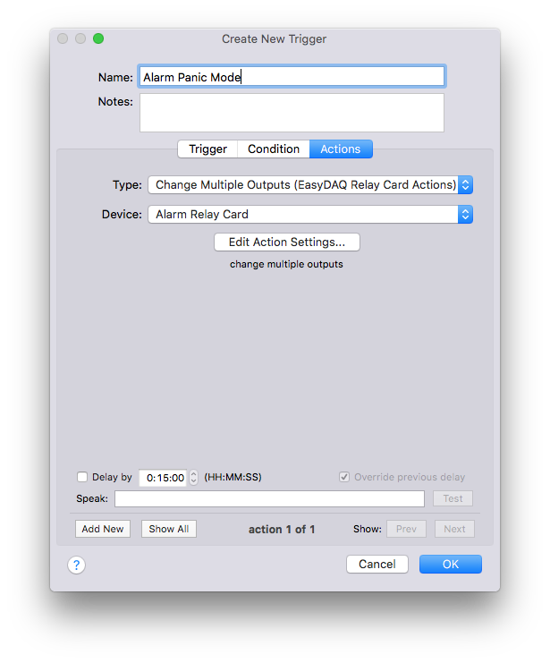

The output channels are controlled via Indigo actions. The actions can be inside Triggers, Schedules, Action Groups, or assigned to Control Page controls. From the Action panel inside these dialogs choose Plugin from the Type popup control, and then choose the Action you want to perform and the target Device:
Easydaq Action Panel Window Image

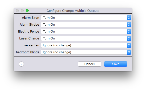

Some actions have additional options available via the Edit... button. For example, the Change Multiple Outputs action allows you to control (turn on, turn off, or toggle) all the outputs with a single, and very fast, action:
Easydaq Action Change Multi Window Image

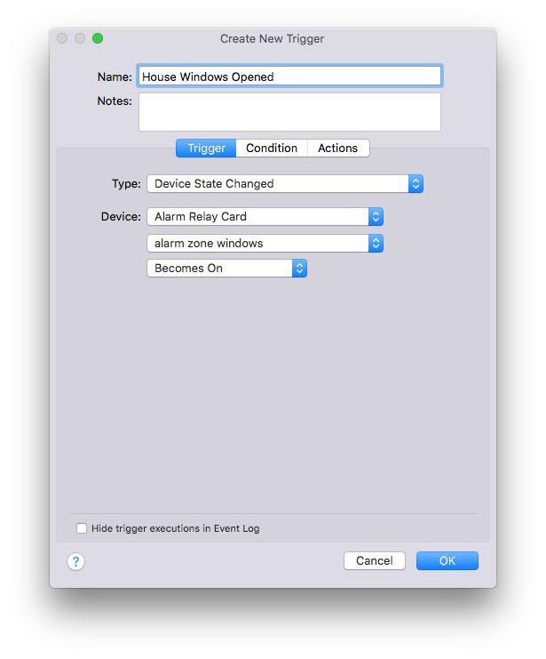

Indigo will automatically track all input and output channel states. To trigger an action when a particular channel state changes from OFF to ON (or ON to OFF) choose the File->New Trigger menu item, and select Device State Changed from the Type popup control. Next, select the Indigo device representing the EasyDAQ card you want to monitor, and then choose which channel change will cause the trigger:
Easydaq Trigger Device State Change Window Image
You can then use the Condition panel to add further logic, and the Actions panel to define the action you want executed (ex: turn on lights, send an email, etc.)

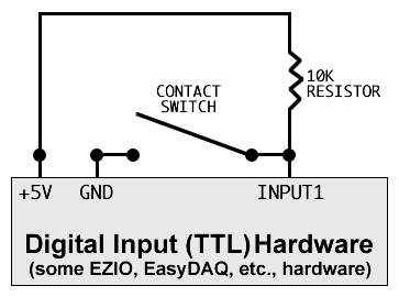

However, some TTL based input hardware will have a "floating input" problem when the switch is open. In such an open state the INPUT pin on the hardware will be connected to nothing and the TTL circuitry will bounce between showing ON and OFF. You'll know this is a problem because there will be a continuous stream of changes logged inside Indigo when the switch is in the open state.
The solution in this case is to use a pull-up resistor (RadioShack will have the 10K resistor needed) so that the INPUT pin is never left in a floating, or unconnected, state:
Pull Up Resistor Image
When the closure switch is in the open state, the INPUT pin is pulled up to +5V through the 10K resistor. When the closure switch is in the closed state, INPUT will be forced to GND (+0V). Note the 10K resistor is needed so that there isn't an unloaded (no resistance) short between +5V and GND when the switch is closed. By using a 10K resistor, only a tiny amount of current will flow from +5V to GND when the switch is closed.

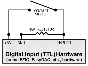

Note the above circuit will have INPUT pulled to +5V when the circuit is open, and INPUT will be GND when the circuit is closed. If this is the opposite of what you want, then you can use a pull-down resistor circuit instead:
Pull Down Resistor Image
