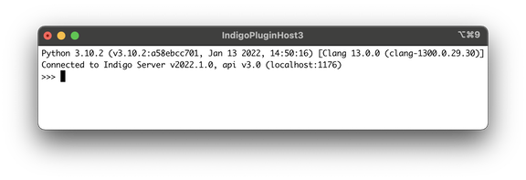

/usr/local/indigo/indigo-host
Plugin Host Prompt Image
Connecting Remotely over SSH
What Else Can it Do?
The IPH gives you full access to the Indigo Object Model (IOM) providing access to create/edit/delete/control Indigo objects, as well as several Indigo utility functions, Insteon device commands, and X10 device commands. Access to all of this functionality is provided by the indigo module automatically loaded and included in any python scripts run by the IPH (including interactive IPH sessions like we are using here).
