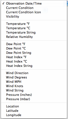

NOAA Trigger States Image
Weather Station device types provide you with several device states that you can use in the Trigger dialog:
  • Current Condition - The current condition in a word or two
  • Current Condition Icon - The current condition icon - Indigo ships with "NOAA Condition+.png" and its children, one for each condition that's returned in this field. So, in the control page editor, select this state and "NOAA Condition+.png" and you'll have a nice conditions icon (images provided by NOAA).
  • Dew Point °C - Dew point in Celsius
  • Dew Point °F - Dew point in Fahrenheit
  • Dew Point String - Dew point in a human-readable string
  • Heat Index °C - Heat index in Celsius
  • Heat Index °F - Heat index in Fahrenheit
  • Heat Index String - Heat index in a human-readable string
  • Humidity - The relative humidity
  • Latitude - Latitude
  • Location - Location in human-readable form
  • Longitude - Longitude
  • Observation Date/Time - The last time NOAA updated the data. This field is in YYYY-MM-DD HH:MM:SS so it can be parsed by other software if needed.
  • Pressure (inches) - Pressure in inches
  • Pressure (mbar) - Pressure in millibars
  • Quality Codes - For scripters to account for the relative quality of the various weather observations (JSON). See below for what the codes mean.
  • Temperature °C - Temperature in Celsius
  • Temperature °F - Temperature in Fahrenheit
  • Temperature String - Temperature in a human-readable string (i.e. "98.0 F (36.7 C)") - this is the state shown in the "State" column for a Weather Station device
  • Time Zone - The timezone as it applies to the observed location.
  • Visibility - Visibility in miles
  • Wind Degrees - Wind direction in degrees
  • Wind Direction - Wind direction description in something close to human-readable form
  • Wind Knots - Wind speed in knots
  • Wind MPH - Wind speed in miles per hour
  • Wind String - A description of the wind in human-readable form
