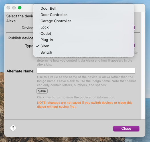

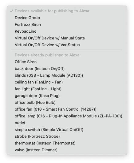

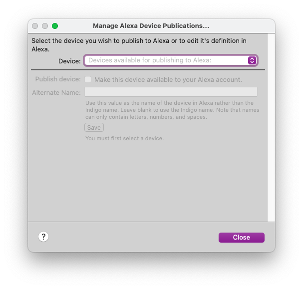

To make a device available to Alexa, you must explicitly publish it. Use thePlugins -> Alexa->Manage Device Publications... menu item to open the publication dialog:
Alexa Type Popup Image
You will use this popup to tell Alexa more specifically what kind of device it is. We will attempt to look at various other characteristics of the device to select what we believe is the appropriate type, but you may select any from the list, and we will relay that information to Alexa so you can control it using appropriate terminology (see below for specifics).
Warning
Be sure to click the Save button before moving on or your changes won't be saved. Also, if you make any changes, you will need to rerun discovery from an Alexa device or the Alexa app before those changes will be reflected. As a reminder, you must either click the discover devices button in the Alexa apps or ask "Alexa, discover devices" of an Alexa enabled device.

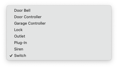

Alexa Relay Subtypes Image
The options are:
    • Alexa, open the front door
  • Garage Controller - this is exactly what you think it is. You will be able to open/close (raise/lower) your garage door. Alexa uses this control type as a more secure option. When Alexa first discovers a garage door, it will not allow you to control the door by voice. Rather, it will tell you to control it manually or go to the Alexa app and configure the door for use with voice control. In the settings for the door in the Alexa app, you will be able to enter a 4-digit PIN for extra security. When you ask Alexa to open or raise the door, you will be prompted for your PIN code. If you have an automatic door controller (specified above) and want the extra security of a PIN code, you can select Garage Controller as well, and it should work just like a garage door. PIN codes are set per device so each can be different. You can say things like:
    • Alexa, open the garage door
    • Alexa, lock the back door
    • Alexa, turn off desk lamp

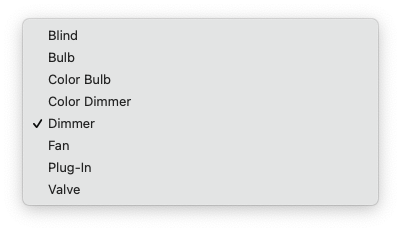

Alexa Dimmer Subtypes Image
The options are:
    • Alexa, close the shades
    • Alexa, increase ceiling fan speed
    • Alexa, turn off ceiling fan
    • Alexa, set the valve to thirty percent
    • Alexa, turn off the valve
