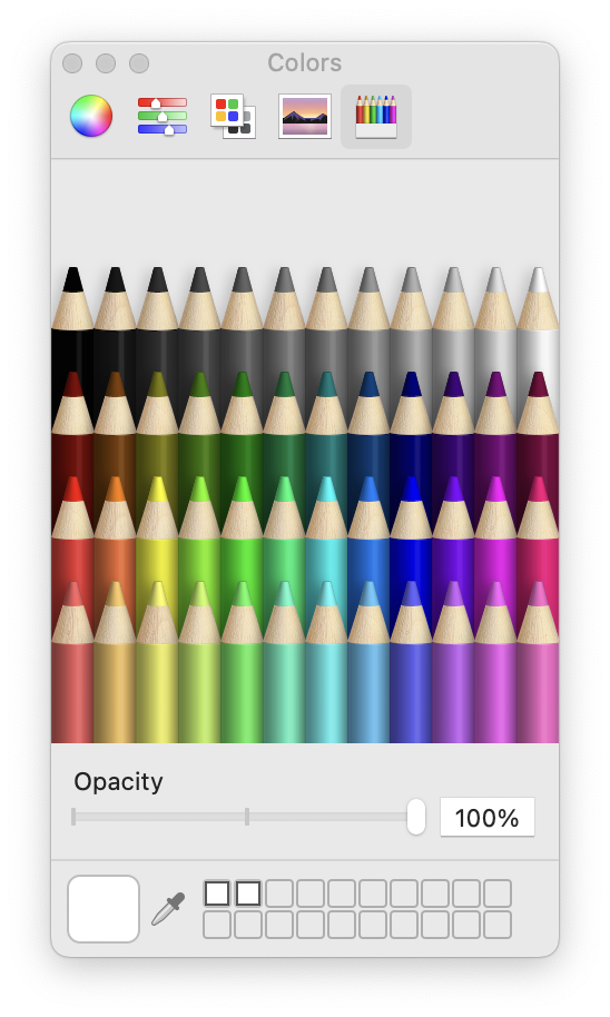

Color Selector
After the user selects a color, the color’s value will be passed back to your plugin as a values_dict value when the user executes/closes the configuration dialog. Note that the value provided is a standard RGB value as a space-delimited string. You are responsible for converting that value into the format you need like #8000FF.
