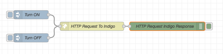

Node-RED Image

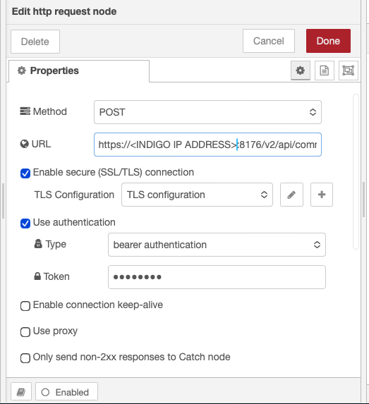

Using the flow via https requires a few settings. Enter the preferred URL to point at the local IWS address *10.0.1.123*, *127.0.0.1*, or *localhost* with the URL:
https://<INDIGO IP ADDRESS>:8176/v2/api/command/
for example,
https://10.0.1.123:8176/v2/api/command/
Node-RED 6 HTTP Request Node Image

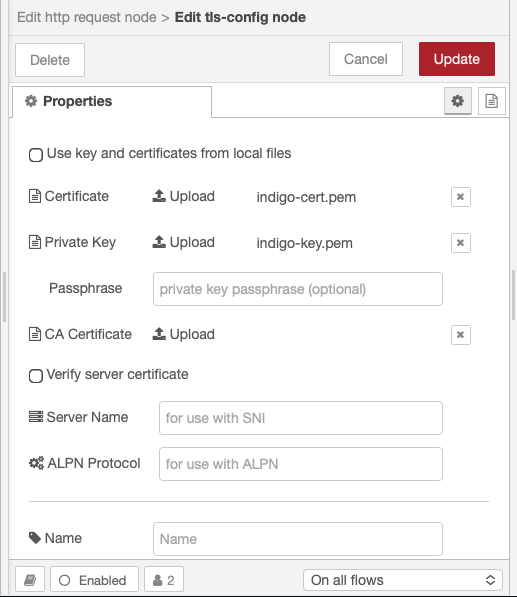

select TLS, and use bearer authentication along with a valid token key (from your Indigo Account Authorizations).
Then, use the key and certificate from local files and point them to the certificate and public key files located in
/Library/Application Support/Perceptive Automation/Indigo 2026.1/Web Assets/cert/
Node-RED 7 HTTP Request Node Image

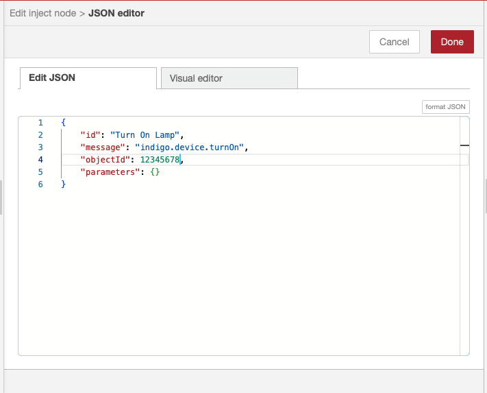

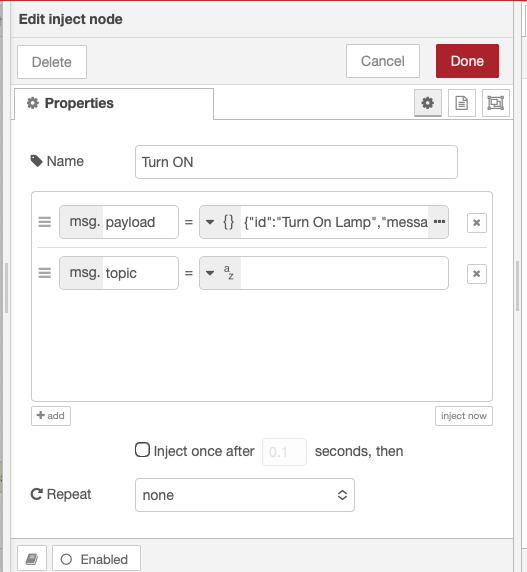

Node-RED Inject Node Turn On Image
Node-RED Inject Node Turn On JSON Image

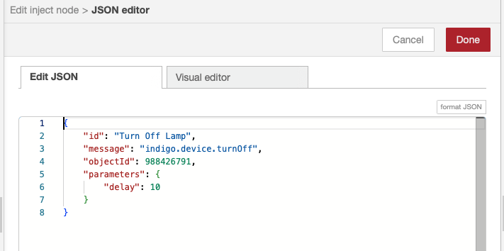

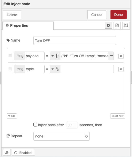

Node-RED Inject Node Turn Off Image
Node-RED Inject Node Turn Off JSON Image

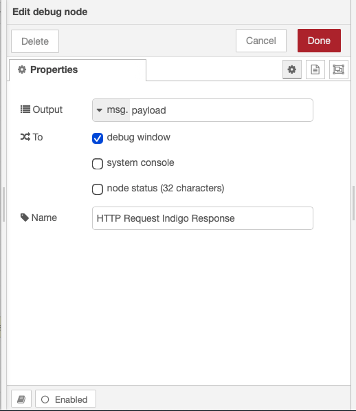

Node-RED HTTP Debug Node Image
