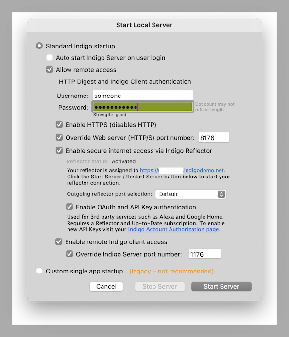

Starting Indigo Server
  1. Double-click the Indigo 2026.1 application (/Applications/Indigo 2026.1.app).
  2. If this is the first time to run Indigo 2026.1 on this Mac, then press the Start Local Server... button in the connection status window.
  3. If you want to reconfigure the Indigo Server on a Mac already running Indigo, then select the Indigo 2026.1->Start Local Server... menu item.
Start Server Dialog Image
Password Field Behavior
The length of the entry in the password field does not reflect the length of the actual password entered. This is intentional and is meant to add a layer of security so a bad actor can't guess the true password's length.
Standard startup mode
Choose the Standard Indigo Startup radio button to start the Indigo Server process independently of the Indigo Client. This will allow the server to run in the background on your Mac with no visible UI, even when the Indigo Client is not running. This will also start the built-in Web server, allowing remote access from Web browsers on other computers and remote access from iPhones and iPod touches.
Use the Auto start Indigo Server on user login checkbox to have the Indigo Server automatically launched whenever your current macOS administrator user account is logged in. This option will also make sure the Indigo Server process is automatically relaunched if it crashes.
Use the Enable secure internet access via Indigo Reflector checkbox for secure Web browser access from anywhere. This option requires you to have configured a Reflector, which handles maintaining the secure connection to Indigo Server automatically. Reflectors are included as part of your Up-to-Date subscription.
  • Outgoing reflector port selection: Some ISPs, especially satellite providers, may block incoming and outgoing connections -- particularly if they sit idle for a time (which, in our opinion, is ridiculous) -- this setting provides a few options to hopefully work around these limitations. The setting you choose does not have any impact on performance. Further, the reflector port selection (or, in fact, the reflector itself) should have no impact on local web traffic performance (since the reflector isn't involved when a local network connection is made). If you're experiencing slowness with a local connection, check your router to ensure it isn't blocking or otherwise interfering with Bonjour traffic.
Use the Enable OAuth and API Key authentication checkbox to enable third-party services like Alexa. It also will allow REST API calls to use an API key for authentication rather than a username/password. This is more secure since you can revoke a key if it gets compromised without having to change passwords wherever you may need to use them.
Use the Override Indigo server port number: checkbox to change the TCP/IP port number that the macOS client uses to connect to the server.

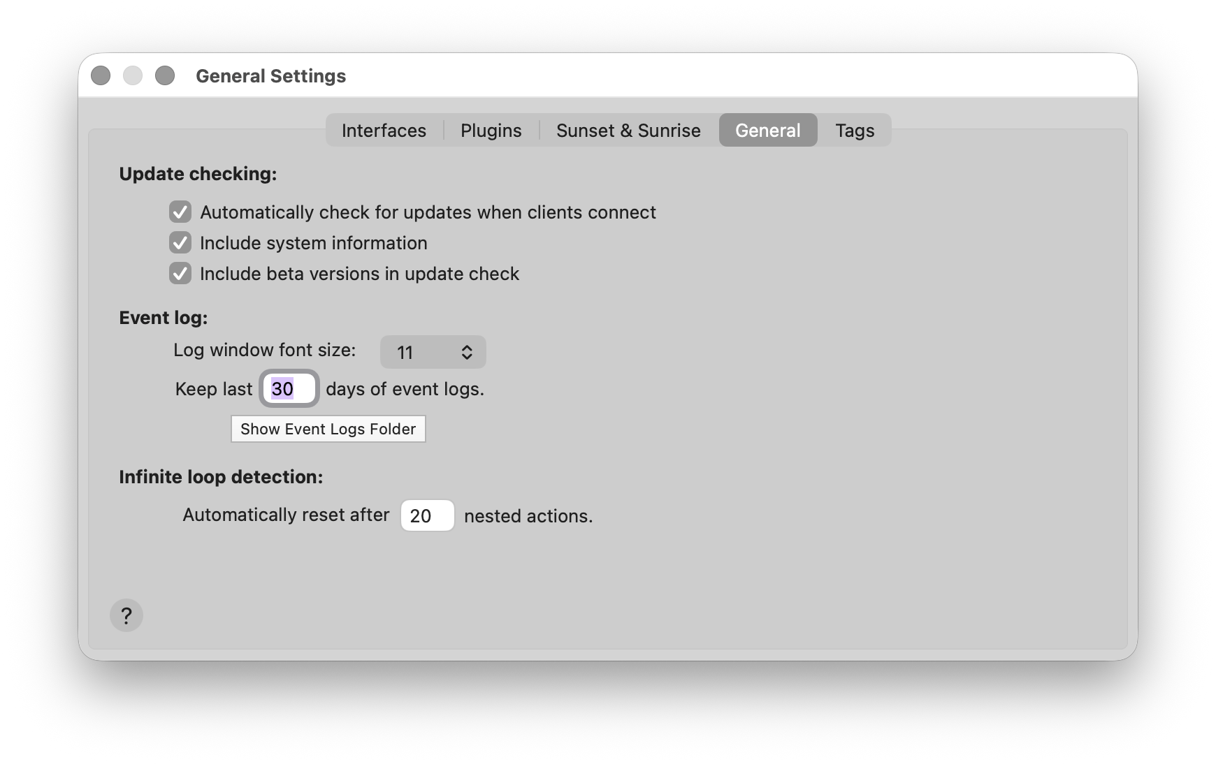

You can configure other Indigo settings by opening the preferences dialog (selecting the Indigo 2026.1->Preferences... menu item) and clicking on the General tab.
You can have Indigo check for updates immediately by selecting the Indigo 2026.1->Check for Updates... menu item.
The last section is a rather technical configuration parameter - it is possible to get into an unending (infinite) loop when you're setting up your triggers. For instance, if you have a trigger that fires on a variable change, and it changes the variable to some new value each time, that would cause the trigger to fire again. Setting this value will cause it to stop eventually. Leaving it set to 5 is probably the best idea.
The Tags tab of the same dialog is where you create, rename, recolor and delete tags. Edit->Manage Tags... opens it directly.

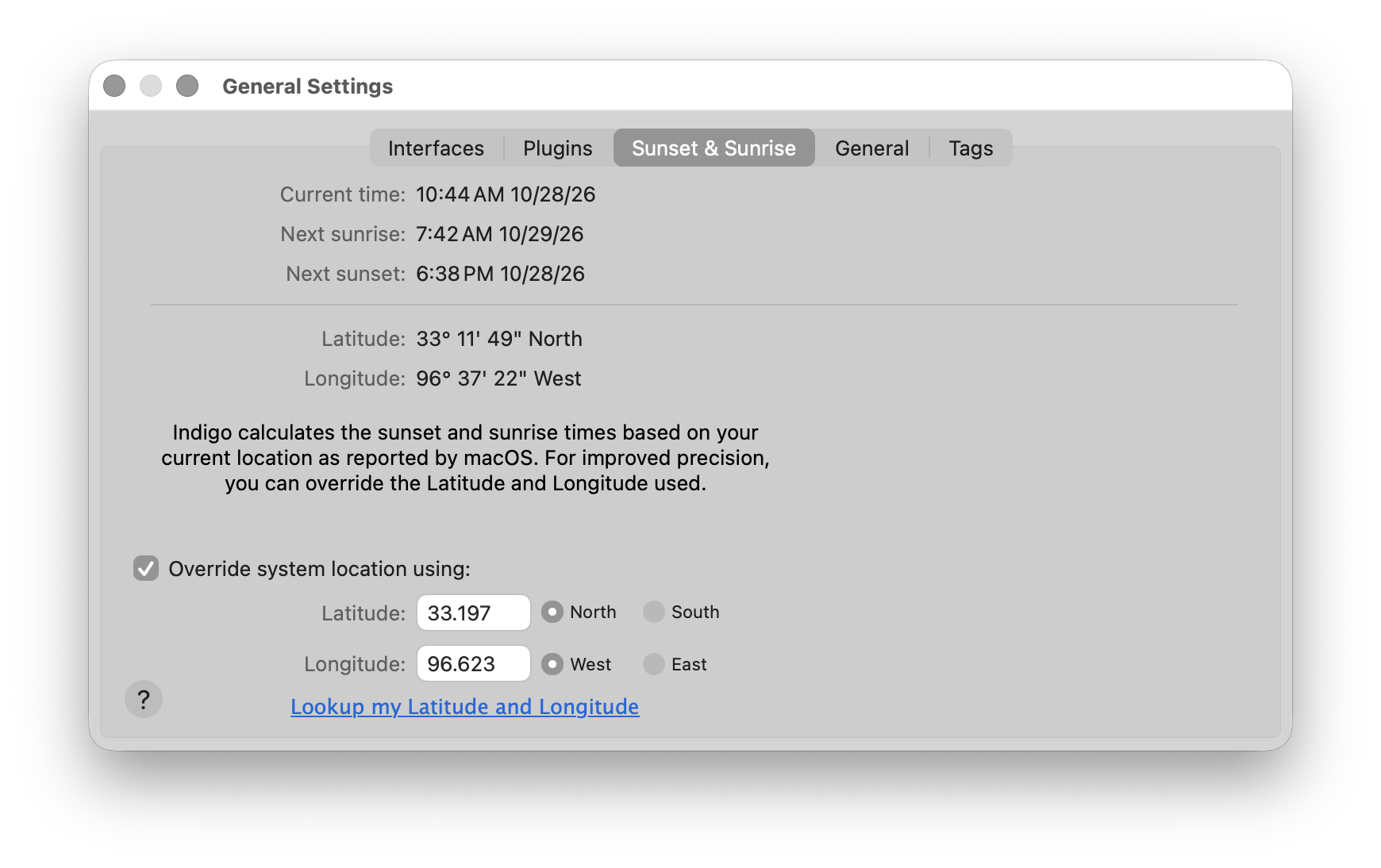

Indigo uses your current Latitude and Longitude coordinates to calculate precisely when sunset and sunrise will occur every day. Indigo automatically extracts your location from the System Preferences. To do this, it must have access to Location Services on your Mac (and Wi-Fi must be turned on for Location Services to work). When Indigo first launches, you'll be prompted to allow access to Location data. If for some reason it's not working, check the Location Services section on the Privacy tab of the Security & Privacy section of your System Preferences and make sure that IndigoServer is enabled (has a checkbox beside it).
  4. If the current Closest City location is not near your location, then follow the instructions on the panel to choose your location.
By default, Indigo will use Location Services to determine the location of your Mac. You will be asked the first time you start your server to grant permission for IndigoServer to access your Mac's location. If Indigo doesn't seem to be running schedules at the right time, make sure that Indigo is authorized to access Location Services. Open the System Preferences, select the Security & Privacy preference, click on the Privacy tab and you should see IndigoServer in the list - make sure the checkbox beside it is enabled:

  • Choose the Indigo 2026.1->Preferences... menu item, then make sure the Sunset & Sunrise tab is selected.
