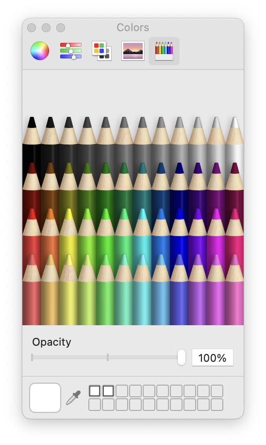

Color Picker fields allow your user to choose a color value. For example, you might provide a method for a user to select a color for an RGB LED device. When the user clicks the color button, Indigo will open the standard macOS color selector dialog.

Color Selector
After the user selects a color, the color’s value will be passed back to your plugin as a values_dict value when the user executes/closes the configuration dialog. Note that the value provided is a standard RGB value as a space-delimited string. You are responsible for converting that value into the format you need like #8000FF.
