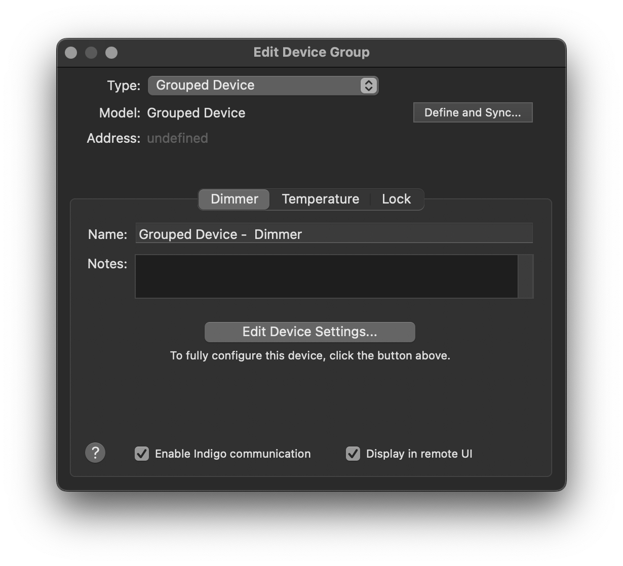

Device Factory
One way to create "multifunction" devices is to use Indigo's Device Factory method. Device Factory devices are defined by using a special <DeviceFactory> node in Devices.xml. A basic Device Factory device definition would look something like this:
<DeviceFactory>
    <ConfigUI>
        </Field>
            <Label>Name:</Label>
        </Field>
    </ConfigUI>
</DeviceFactory>
Note that when the <DeviceFactory> node is present, devices that include the subType attribute will not be presented to the user as individual device types when they elect to create a new plugin device (it's not possible to have a Device Factory implementation and individual plugin device definitions together). You define sub-devices like any other device type, with the addition of the subType attribute:

Once the device definitions have been established, you can use your plugin code to create the device group. This function can be called from the validate_device_factory_ui() or closed_device_factory_ui() methods.
    # Create the first device in the group. Note that the 'deviceTypeId' value matches the 'id' we used in our 'Devices.xml' definition.
    new_dev.subModel = "Dimmer"
    new_dev.replaceOnServer()
    new_props['name'] = my_name
    new_dev.subModel = "Lock"
Important
You are responsible for catching all the mandatory methods for the devices you create. The Device Factory method does not create them for you.
