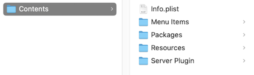

The Info.plist File
There’s only one file that’s directly inside the Contents folder, and it’s required (read very important). The Info.plist file is a standard XML property list file that contains several important key/value pairs. The keys in this file will help Indigo understand what functionality your plugin provides, what its name and version number are, etc.

You can drop Python scripts into this folder, and they will show up in your plugin's sub-menu on the new "Plugins" menu. When the user selects the menu item, the script is executed. This is a really simple way of giving your plugin some visible UI.
Resources Folder
This folder is meant to contain any assets (like images, templates, etc.) that your plugin might need. If there is an icon.png file in here, it will be displayed in the Plugin Store once you submit the plugin to the Indigo Plugin Store. Note that the code that loads config UI XML templates assumes that the Server Plugin folder is the root, so those template files should always be in the Server Plugin tree (e.g., Server Plugin/Templates/my_template.xml).
Packages Folder

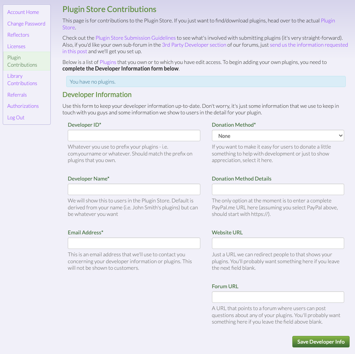

Creating Your Developer Account
If you haven't already, you'll need to go to the Plugin Contributions page in your Indigo Account and add your developer information:
Plugin Contributions Image
Please read through the entire top section of that page as it contains important information.

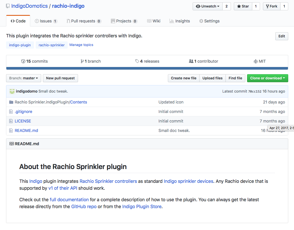

At the top level of the repo should be your plugin folder and an optional README file. You may have other files in there as well, like the LICENSE file in the rachio-indigo repo above. The plugin is there for obvious reasons — it's the path into the source for your plugin. The README file's contents will automatically be used as the plugin's description and shown on the About tab on your Plugin's detail page:

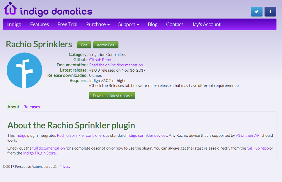

Rachio Plugin Store Detail Image
Markdown in the README.md file will be rendered correctly in the Plugin Store though you can also use a plain text file (README.txt).

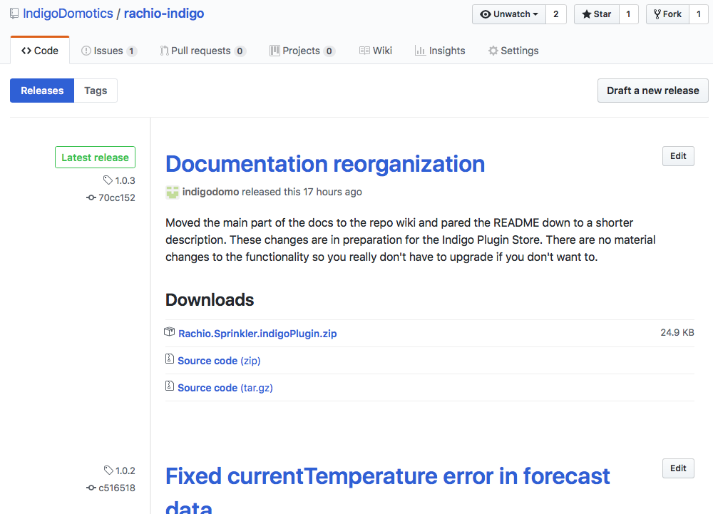

GitHub Releases
When you are ready to publicly release a version of the plugin (either initially or a follow-up release), you should add a release in GitHub:
GitHub Releases Image
We do not look at the "master branch" (or "tips") of the repo. Only published releases (not pre-releases) will be added to the Plugin Store's release list (see Adding a GitHub Release below for details). The Plugin Store currently doesn't support listing betas (pre-releases) but you can still create them and point your beta testers to them on GitHub (one of the advantages to using GitHub).

There are a few requirements for GitHub releases:
  • The GitHub release tag # must match PluginVersion in the Info.plist file, otherwise the release will be rejected when added to the Plugin Store. Note: we will be looking in the source code zipball from the release for the Info.plist, not the attached plugin. If you're getting the mismatch error, that's where you'll need to look to fix any mismatching version numbers.
  • The README.md or README.txt file must be at the top level of the archive for it to automatically be used. This is to avoid issues if your plugin includes other source projects that may also have their own README files.
  • Although optional, we strongly encourage you to add a zipped version of just the plugin folder (not the entire repo) to each release. Make sure that indigoPlugin is in the name and that it's a zip file (e.g. MyPlugin.indigoPlugin.zip) and make sure that there aren't any other zip files attached to the release. If you don't include an attached zipped plugin, the user will download a zipped copy of the repo itself, including the plugin, the README, etc. (basically everything in the repo). This may make it confusing for users to find and install the plugin.

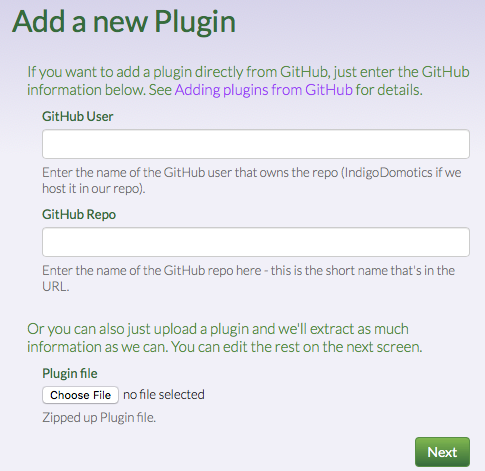

As we mentioned at the top, there are two ways to add a new plugin to the Plugin Store: by specifying a GitHub repo or by uploading an existing plugin:
Add Plugin Image
Note
There is no automated way to convert between a GitHub-based plugin and a directly managed plugin, so please carefully consider which approach you want to use before initially adding the plugin (we recommend GitHub!). We can manually convert between the two, but it takes some time and effort.
Adding a Plugin from GitHub
To add a new plugin from a GitHub repo, just enter the GitHub user and repo names. As an example, for our Rachio Sprinkler repo, which is located here:
https://github.com/IndigoDomotics/rachio-indigo
We entered IndigoDomotics for the user and rachio-indigo as the repo. Note your repo must have at least one published release to be added to the Plugin Store.

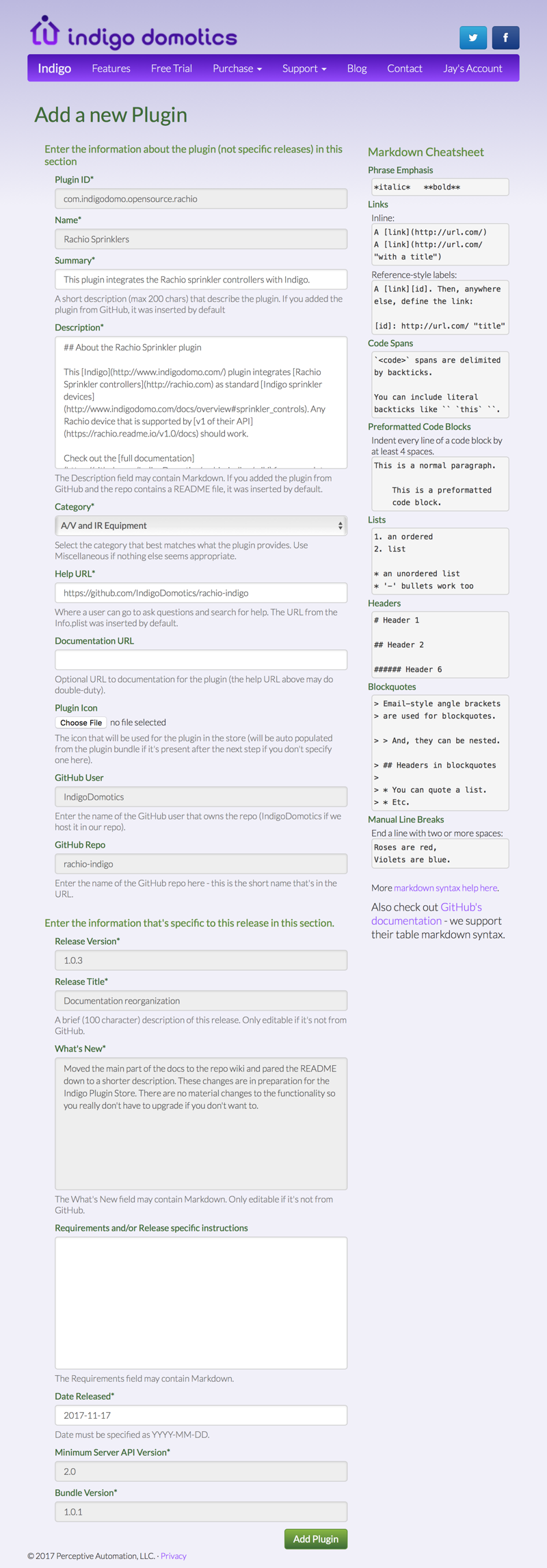

Click the Next button and you'll see the following page with the appropriate data pre-populated:
Add Plugin From GitHub Image

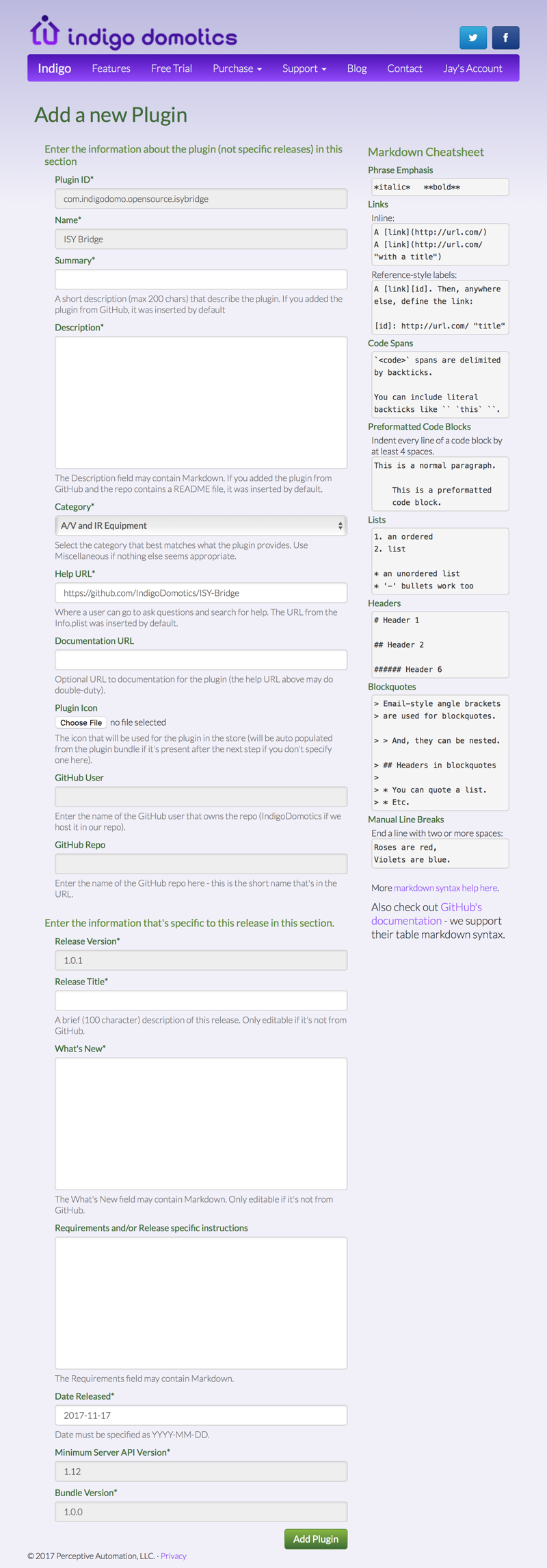

This form has a variety of fields (some read-only) that fall into two groups. The first group are fields about the plugin itself (not any specific release of the plugin):
  1. Plugin ID — the ID from the Info.plist file (read-only).
  2. Name — the name from the Info.plist file (read-only).
  3. Summary* — a very brief (200 character) summary of your plugin. It is pre-populated with the description for your GitHub repo but you may edit it as you want. It will never be overwritten from GitHub.
  4. Description* — the README file's contents from the repo will be inserted here. It may contain Markdown and you can edit it to make any changes you like. You will have the option of updating it from GitHub when you add new releases.
  5. Category — the major category of your plugin. If you can't find one that seems suitable, then select Miscellaneous. This can be changed later.
  6. Help URL* — the help URL pre-populated from the Info.plist. You may override it and it will never be overwritten automatically.
  7. Documentation URL — a separate and optional URL that can point to more comprehensive documentation. This is a good place to put the URL to the GitHub wiki for this repo (see the Rachio Plugin's wiki page for an example).
  8. Plugin Icon — if your plugin's bundle has an icon (Contents/Resources/icon.png file) then it will automatically be used if you leave this field blank. Alternately, you can add a PNG file here.
  9. GitHub User and Repo — a read-only copy of what you entered on the first screen.
And the next section is specific information about the release that you're adding:
  1. Release Version — automatically retrieved from the releases section of GitHub. If you have more than one release in the repo, this will be the most recent (only releases that are not marked pre-release or draft are used). Note: the release version number in the GitHub release source zip's Info.plist must match the tag for the GitHub release. Otherwise, the release will not be added. This sanity check will help ensure that you don't end up with version mismatches and the associated problems that will result (failed update checking, failed upgrades, etc.).
  2. Release Title — also retrieved from GitHub, it's the short release title.
  3. What's New — again, retrieved from GitHub, this is the full description of the release.
  4. Requirements — an optional separate field that may contain Markdown. The intention of this field is to outline any specific requirements or steps needed for this release. GitHub doesn't have anywhere (other than the release description) to put this kind of information. You may, of course, just add it to the description (and therefore the What's New section) and leave this field blank. We won't show it if it's blank.
  5. Date Released — the release date as specified in the GitHub release info. You can change it here if you like, using the YYYY-MM-DD format. Note if you change it to some date in the future it won't show up in the Plugin Store until that date.
  6. Server API and Bundle Versions — retrieved from the Info.plist and just shown here for completeness. The Server API version is particularly important in that it determines what's shown as the minimum Indigo version required to use the plugin.
Required fields are marked with an asterisk (*). The majority of GitHub repos will have all the information needed for the required fields so it's only likely that you'll have to edit the Category field as a minimum (and if your plugin is an A/V or IR plugin you won't even have to do that!). Once you have reviewed all the form fields hit Add Plugin.

Adding a Directly Managed Plugin
To add a new plugin from an existing zipped plugin, just click the Choose File button and select the file. Note that Safari will automatically zip plugin folders before uploading (but your browser of choice may not).
Click the Next button and you'll see the following page (with the appropriate data pre-populated):

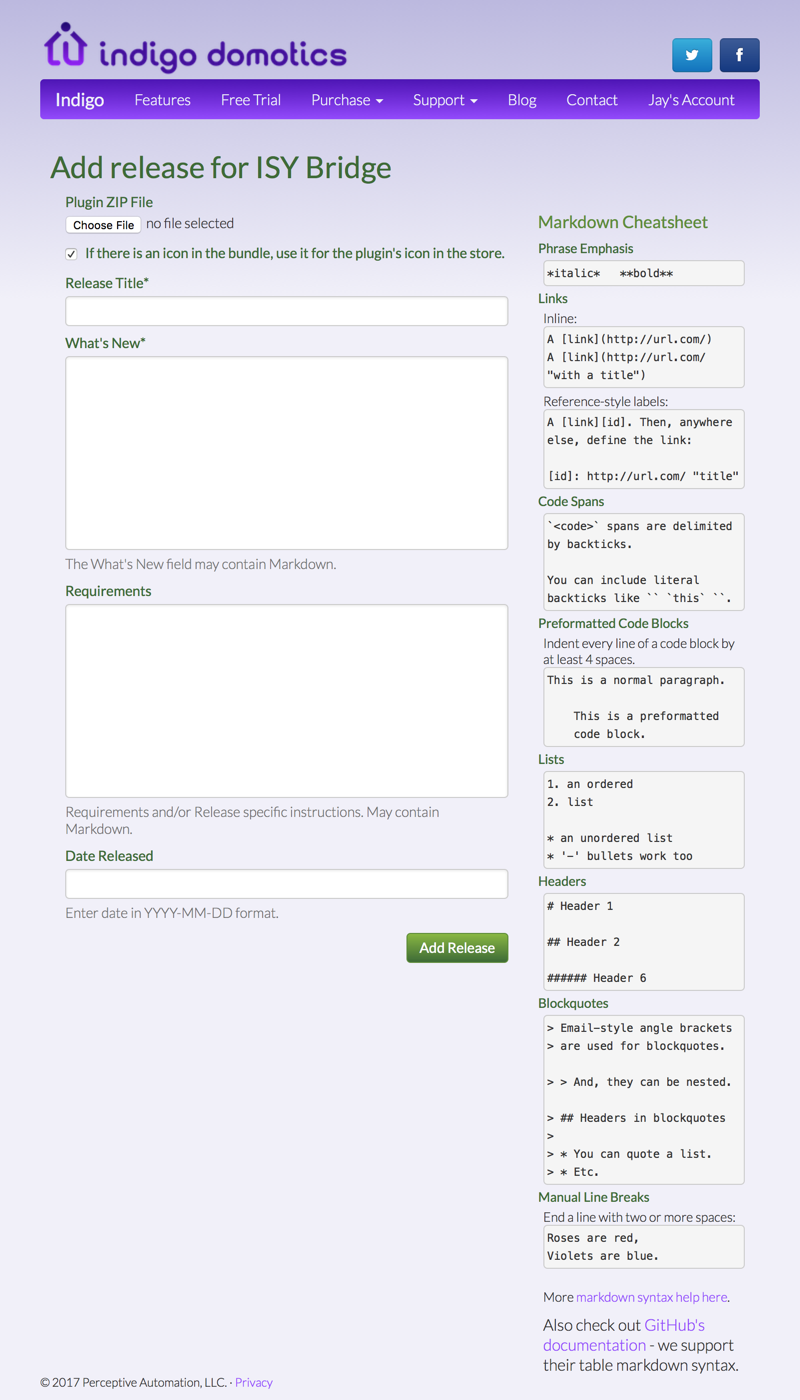

Adding a new release this way isn't really very hard either, there are just a few fields you need to fill out:
Add Plugin Release File Image
  1. Plugin ZIP File — click the Choose File button and select the plugin folder. Note that Safari will automatically zip plugin folders before uploading (but your browser of choice may not).
  2. If there is an icon in the bundle, use it for the plugin's icon in the Plugin Store — if checked then the icon in the bundle will replace the icon currently being used.
  3. Release Title* — a short summary (100 characters max) of this release of the plugin.
  4. What's New* — a full release description. This field may contain Markdown.
  5. Requirements — an optional separate field that may contain Markdown. The intention of this field is to outline any specific requirements or steps needed for this release. You may, of course, just add it to the What's New section and leave this field blank. We won't show it if it's blank.
  6. Date Released — the release date defaulting to today. You can change it here if you like, using the YYYY-MM-DD format. Note, if you change it to some date in the future it won't show up in the Plugin Store until that date.
Required fields are marked with an asterisk (*). Once you've filled out the form hit Add Release.
You'll notice that on the right side of the screen we've provided a quick cheatsheet for Markdown syntax. This will be helpful when editing any fields that allow Markdown.
Editing a Release

Icons and Branding
The Plugin Store shows icons for each plugin. If you don't include one in the plugin bundle (Contents/Resources/icon.png) and you don't add one explicitly to the release (see Adding a Release for details) then the default Indigo Plugin icon Plugin Image will be shown.
To make it easy for users browsing the Plugin Store to identify something they're looking for, it's quite helpful to include an icon that represents what your plugin does. For instance, if you are integrating a specific vendor's products (like the Rachio Sprinkler example above) then you'll probably want to use their icon. Here are some tips to help find an appropriate icon:
  • Many companies provide media links, including icons, that can be used for promotional purposes.
  • Some do it as part of the developer API documentation (often under "marketing" or some such).
  • You can often find logos on their social media accounts in the photograph sections.
We believe that the vast majority of companies won't mind you using their logos to promote their products as long as it's clear that you have no direct affiliation to the company. If there is an issue it's easy for us to remove.
Icon details: 256 × 256 is the optimal size. Images must be 128px high or they aren't going to look good (somewhat wider might work on some screen sizes). The icons must be .png files and the file name should always be icon.png. Note the macOS Preview app can be used to convert other image formats to .png.

  • Putting your plugin on GitHub will encourage others to help you maintain the plugin. Wouldn't it be great if someone with a problem could actually fix it and submit a patch to you?
  • We highly recommend that you attach a zipped plugin (don't forget to delete the .pyc files) in your GitHub releases. When users click the Download Release button in the Plugin Store, it will download just the zipped plugin (not the entire repo). It'll be much clearer to users what they need to do next.
  • The GitHub wiki page is the best way to provide documentation (see the Rachio and Alexa-Hue Bridge examples). The advantage to using the repo wiki is that others can help you maintain the documentation.
