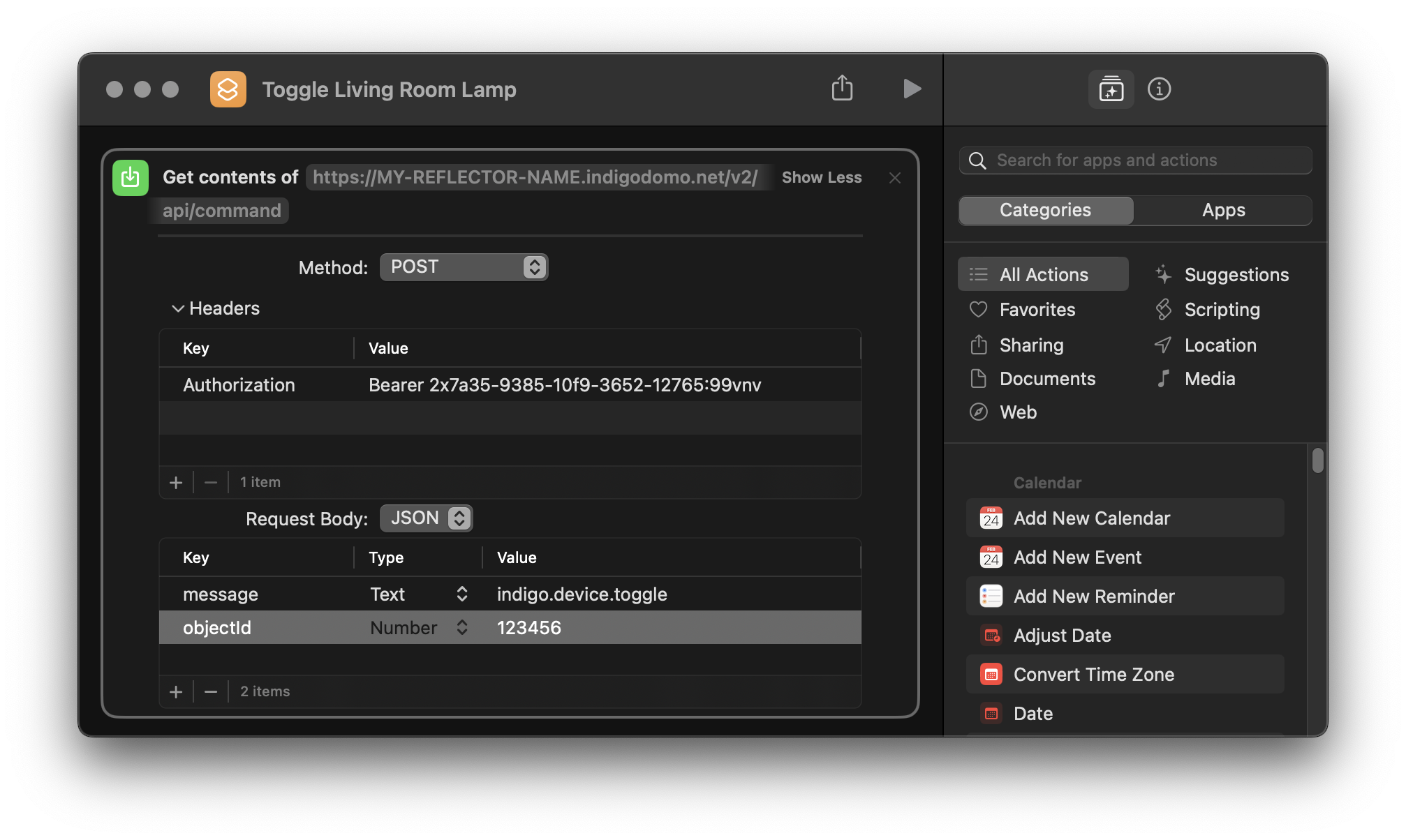

Building Your First Shortcut
Building your shortcut in the Shortcuts app is largely the same whether you do it on macOS or iOS, and -- depending on the type of activity you want to initiate -- only takes a couple of steps. The information you'll need depends on what you want to do, but all the API events are constructed in the same way. For this example, we'll use the macOS Shortcuts App to build our shortcut (you can also do it on iOS and iPadOS). At first, this looks like a lot of steps, but there's actually only a few pieces of information required. All values below are entered without quotes. For our first example, we'll perform a simple Indigo Device Toggle.
You'll need:
  • The base URL: https://MY-REFLECTOR-NAME.indigodomo.net/v2/api/command/ (replace MY-REFLECTOR-NAME with the name of your active reflector),
  • The command you want to execute -- such as: indigo.device.toggle,
The Steps
  2. In the search box on the right side, type "Get Contents of URL".
  5. Click on "Show More".
  6. Select Method: Post.
  9. Under Key: Authorization.
  13. Under Key: message (make sure the Type is set to Text).
  16. Under Key: objectId.
At the top of the Shortcut editor window, you can change "Get Contents of URL" to something descriptive like "Toggle Living Room Lamp". Likewise, you can click on the icon to customize it to your taste. Finally, if you'd like, you can add the Shortcut to your dock (or home screen on iOS), a shortcuts widget, or simply fire them from within the Shortcuts app.

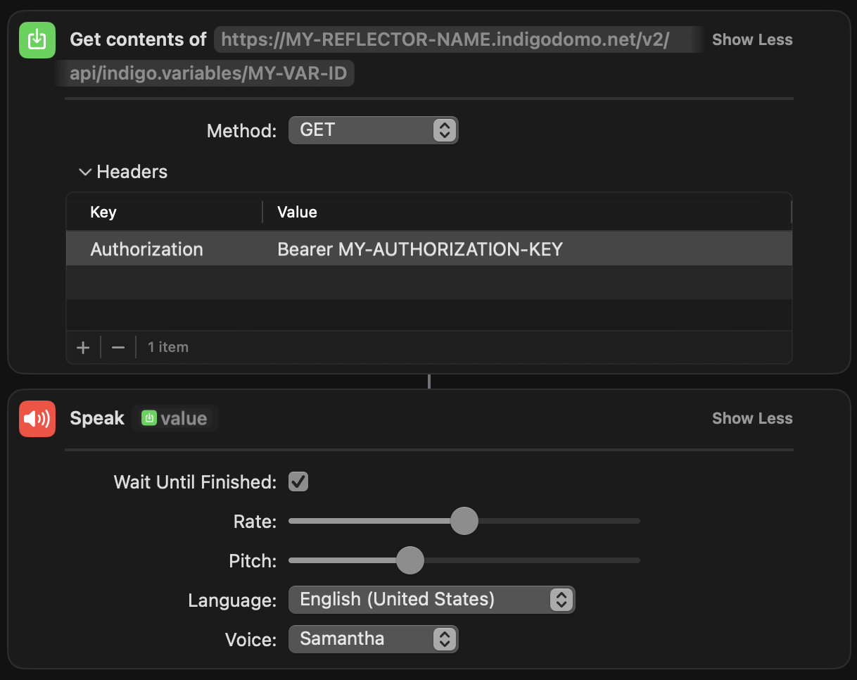

Get a Variable Value
This example shows how to obtain a variable's value and do something with it -- in this case, speak the value aloud. The action you take in your shortcut could be any number of things.
Get a Variable Value Image
  • You can get an individual variable object by referencing its Indigo ID directly %%https://MY-REFLECTOR-NAME.indigodomo.net/v2/api/indigo.variables/MY-VAR-ID%% where you replace MY-REFLECTOR-NAME with your active reflector name and MY-VAR-ID with your variable's ID.

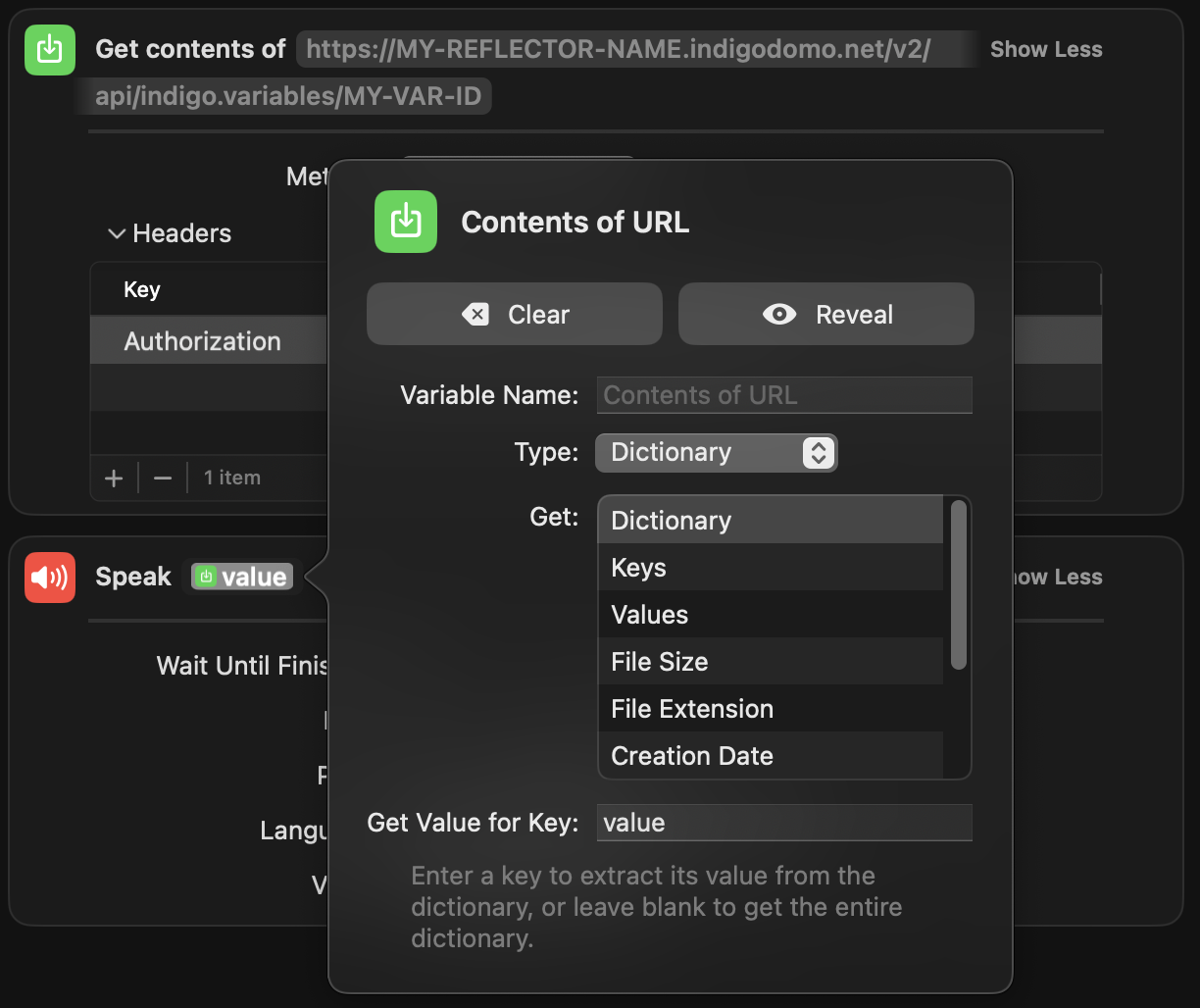

  • The "trick" to getting the variable's value into the speak action is to tell your shortcut what kind of data it is. To do this, click on Get Contents of URL in the speak action, set the data type to Dictionary, and set Get Value for Key to value (be sure to hit return or tab to get the setting value to stick.)
Get Contents of URL Image

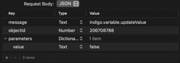

Update a Variable Value
There is currently only one API command for Variables -- indigo.variable.updateValue -- which requires three payload elements:
    • key: value,

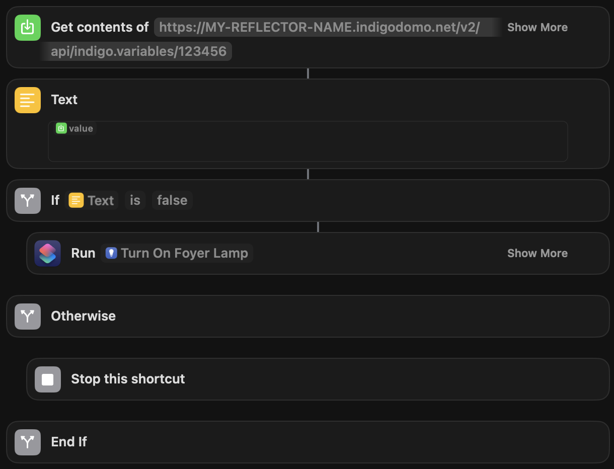

You can include conditions in your shortcuts and take action -- or not -- based on the condition. For example, turn on a light -- but only if it's dark outside.
  • As with the other examples, set up your Get Contents of URL action to get a variable's value -- in this example, the built-in variable isDaylight,

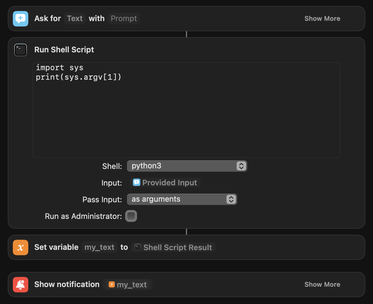

Running an External Python Script
The example below prompts the user for text, passes the text to the script, receives the script's output, and sends that output to a macOS notification. This very basic example is simply to show how to pass input to your script and pass the script's output on to other steps. Note the use of sys.argv[1]. This statement is reading the second argument passed to the script (the first argument is its source--the shortcut itself--which we won't need). The second argument -- sys.argv[1] -- is passed as a string, and that's the bit we need. You'll need to account for whatever format your inputs and outputs turn out to be. These are the two most important settings to this example:
  1. Shell: Python 3
  2. Pass Input: as arguments
The rest is up to you.
Note
The Run Shell Script action is not supported on iOS or tvOS.

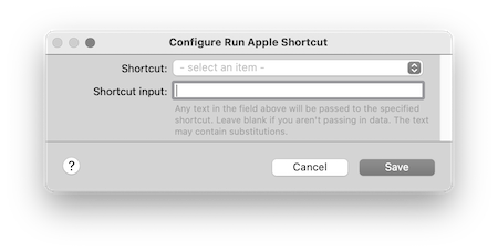

The easiest way to run a shortcut is via an Indigo Action. Create a new Action and select *Server Actions* > *Run Apple Script*. You can optionally add text as input to the shortcut if you wish; otherwise, leave the Shortcut Input field blank.
Run Shortcut Action Image

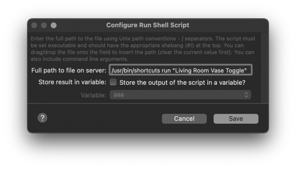

When calling a shortcut from the "Run Shell Script" action, it's best to use the full path to the target: %%/usr/bin/shortcuts%% to make sure Indigo can find it.
Run Shell Script Action
Run Shell Script Action Image

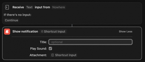

External Shell Scripts

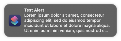

  1. Create your Notification shortcut named "Test Alert":
  2. Create a new shortcut and add the "Show Notification" action.
  3. For Attachment, select "Shortcut Input".
  4. Double-click "Shortcut Input" and select Type: Text
External Shell Scripts Image

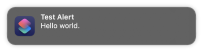

  1. Under Actions, create a new Action (or add a new Action to an existing Action Group).
  4. Enter the full path to your script and the custom message you want to send: /Users/username/Temp/script1.sh "Hello world." replacing /Users/username/Temp/ with the path to your script.
  6. Select Save, and then OK.
From within Indigo, execute your action. The custom message you sent (in this example, "Hello world.") will be sent to the script and will appear in the resulting notification.
Test Alert Image

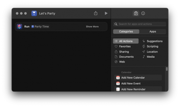

Firing Your Shortcuts with Siri
Of course, you can have Siri run your shortcut by saying the name of the shortcut you want to run. To run the Toggle Living Room Lamp shortcut, say, "Hey Siri. Toggle Living Room Lamp". However, once you begin to have a lot of shortcuts, it can be tough to remember the exact name of every shortcut in your collection. One thing that can help is to create multiple shortcuts with similar names that all point to the same "original" shortcut. That way, if you make a change to the original shortcut, you don't need to change the others (if you change the name of the original shortcut, the Shortcuts app will update the others).
Siri Phrase Action taken
"Party Time" sets lights, temperature, tv, whatever
"Let's Party" Runs Party Time shortcut
"It's Party Time" Runs Party Time shortcut
"I'm Having a Party" Runs Party Time shortcut
