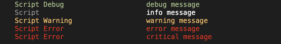

Logging from linked and embedded scripts is very straightforward. You can simply set the level you want by accessing the logging.* level you want:
Command Syntax Examples
import logging
Embedded Script Logging Image
