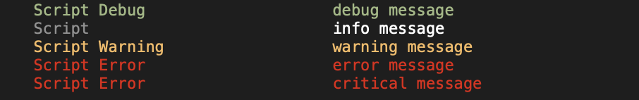

The self.indigo_log_handler is an instance of a custom Handler object that will write (or emit in Python Handler speak) your log messages into the Indigo Event Log. The message type (the left part in the Event Log) is modified so that it reflects the level of the log message (except for the info level). For convenience, the various log levels are also represented in color. Here's an example of each level:
Embedded Script Logging Image
